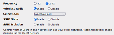

I am having issues with my Sonos speakers. They have issues on the 5G band on this router, so I have moved them to the 2.4G band.
But, the Sonos speakers now are only accessible to other devices that are using the 2.4G band. I can't connect or control them either using the 5G band or hardwire Ethernet connections into the router. If I connect my phone or PC via 2.4G band then everything is good.
I have looked through all the settings in the router and I see an “SSID Isolation” setting on the router configuration, but it is greyed out and the default selection greyed out is showing “disable", so I don't think the 2.4G network should be isolated.
Is there any other setting that can affect network band isolation?

Thanks for the reply, but nothing in your suggestions seems applicable.
AP Isolation or Client Isolation: The only setting I can find on the router is unselectable as already mentioned, but the default is showing as "disable" (no isolation)
VLAN or Subnet Configurations: There are none active
Multicast and Bonjour Settings: Multicast protocol is already active on the Ethernet adapter. If the Bonjour service was needed, then connecting to the network via 2.4G WiFi would not work or be any different that connection via 5G WiFi or Ethernet. If everything is working with a connection via 2.4G then this cannot be the issue.
