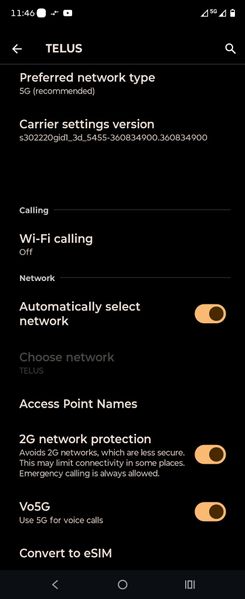

  • Thanks to whoever deleted my last post.  I forgot my IMEI was in that screenshot.  I have included one, now that I am home, with the IMEI removed.

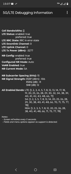

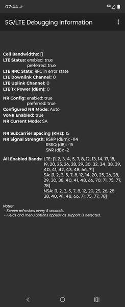

    The next one is the Engineering menu showing VoNR.
  • Thank you for the update Syaoran​
    I don't see any settings for VoNR or Vo5G in the SIM settings on my Pixel 8. Do I need to get it enabled on my account or something?
    • Syaoran's avatar
      Syaoran
      All-Star
      From my understanding.  Right now, it is only available in select locations, like parts of Edmonton and east Toronto.  The option will appear when it is supported on a tower you are connected to supports it, if the device is capable of it.
  • I have been back with Telus for a few weeks now.  When I finally rexeived my pSIM, I tested it in the s23 Ultra Ian from the Senior Network Engineering Team told md almost 2 and a half years ago would never be provisioned because I purchased it from T-Mobile USA.  It worked!  VoLTE showed up, 5G+ app, and everything worked as expected.  Nice to see Telus reverse changes on a stupid policy that never should have been implemented in the first place.  I tried my Moto RAZR Ultra 2025 purchased directly from Motorola USA.  Not only did everything work as expect.  VoNR was also enabled.  I tested it with a few calls with the engineering menu open and it was indeed working.  Very happy with this!  I alao tried my Pixel 9 Pro XL purchased from T-Mobile USA that is running Graphene OS.  Everything works, although VoNR.
    I wasn't expecting VoNR to be oirking but that has made me keep my SIM in my Moto RAZR Ultra 2025.  Telus really needs to advertize that this is working, although only in very select places currently.  The call quality is definitely an improvement, which is why I noticed in the first place that it was enabled.  I know Bell also has select VoNR sites but none of those are in my current area to test.
