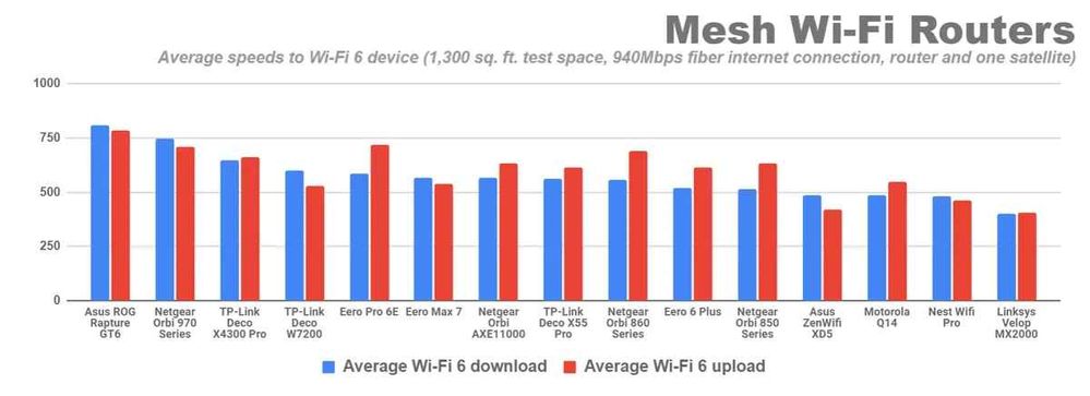

    With the way that mesh routers work, if you put 1gbps in, you'll never see that speed anywhere on the mesh routers, even if you have some seriously expensive hardware. A small number will have faster speeds than the rest. Some Wifi 6 mesh routers only advertise 500mpbs speeds, like Eero 6 does. The more mesh satellite nodes you have, the more the speed can potentially decrease.
    Cnet did a comparison between some of the more common ones. I imagine others will be similar based on price of the hardware.
