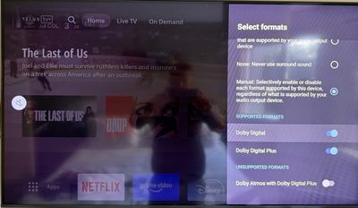

The new equipment supports Dolby Digital, Dolby Digital + and Dolby Atmos with DD+. You can find these options in Settings > Device settings > Device Preferences > Display & Sounds > Advanced sound settings (note that Dolby Atmos shows as unsupported in the picture as my specific setup doesn't support it rather than the equipment not supporting it).
