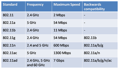

      Possibly your laptop doesn't support newer wi-fi standards? Here is a chart of speeds for the various types of wi-fi:
