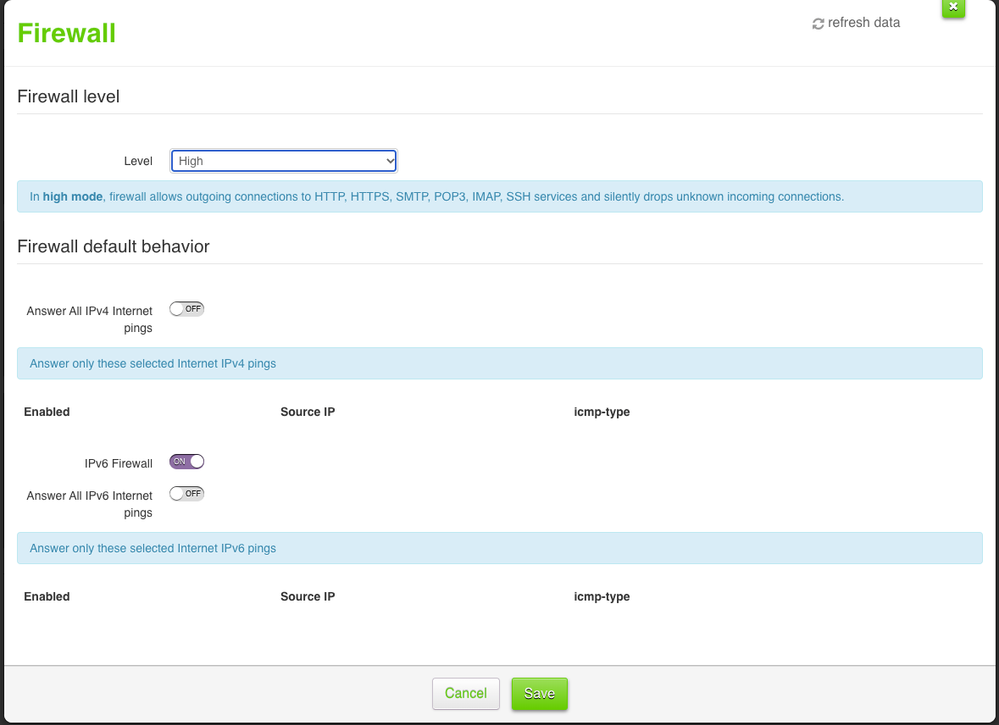

I used to have a Telus Wi-Fi Hub where I had my firewall configured with port forwarding.

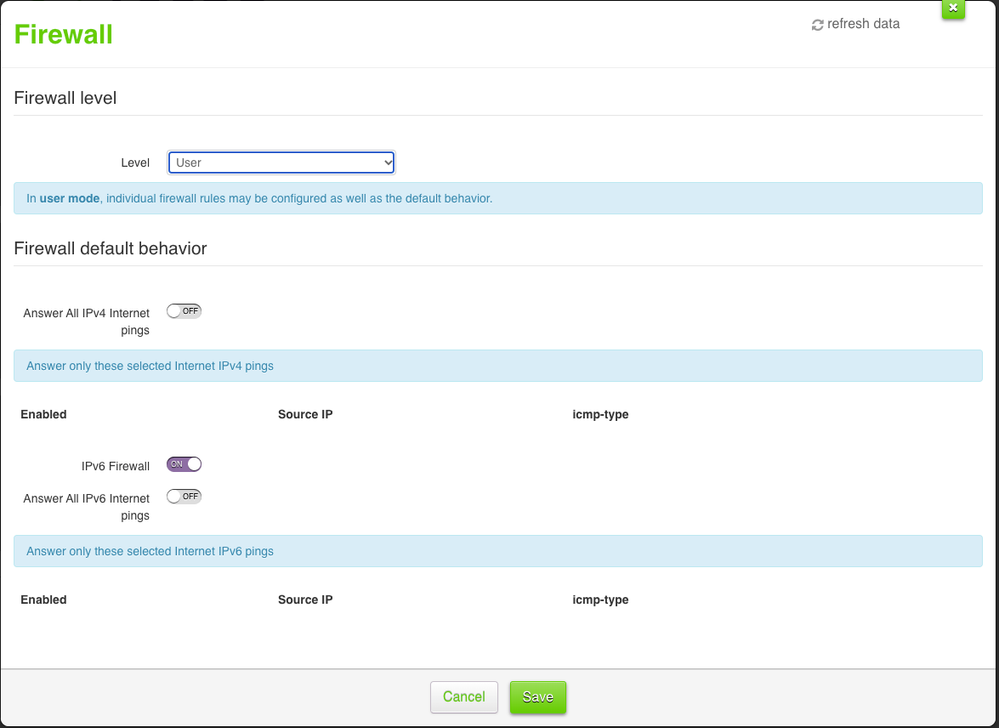

Where is the port forwarding config on a Telus Network Access Hub (aka the white square box, aka the Technicolor FXA5000)?  I can log into the hub at 192.168.1.254 and go to the Firewall section, but there is no advanced screen.  There is no way to add a firewall rule.  Here is a screen shot of the user defined firewall rules and the high settings.
I am doing this in Chrome, so it likely isn't a browser issue.

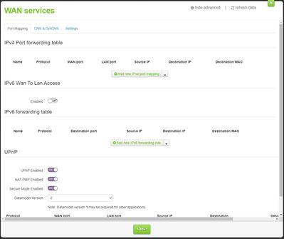

  • robert_wong Wrote: I can log into the hub at 192.168.1.254 and go to the Firewall section, but there is no advanced screen.
    Strange as it may seem, you have to configure Port Forwarding" on the Technicolor FXA5000 under the WAN Services section.
    You will see the advance settings section at the top of the page, and then again the port forwarding input right at the top again...
