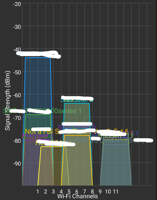

  • Are your devices using 2.4 GHz or 5 GHz WiFi connections?
    If you are using 2.4 GHz and the issues tend to be in the evening then it might be a case of channel congestion. When your neighbors get home and use their devices and you are sharing the same WiFi channels then there can be a lot of noise/errors requiring the WiFi to resend a lot of packets which will effectively give you a lousy transfer speed.
    Contact TELUS customer support and ask them to help you change the 2.4 GHz channel.
    Here's a graph of the 2.4 GHz channel usage at my house. I use channel 1 because there are fewer of my neighbors on it.
