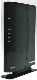

  • To add to my comment, it is best to call in to technical support so they can determine if your WSTB RSSI (Received Signal Strength Indicator) is within the threshold. If not, they will likely book an appointment for a technician to install a wireless extender where you can hardwire/wirelessly connect your VIP5602 so it has closer proximity to the wireless access point (WAP).
     WEB6000Q Wireless Extender
