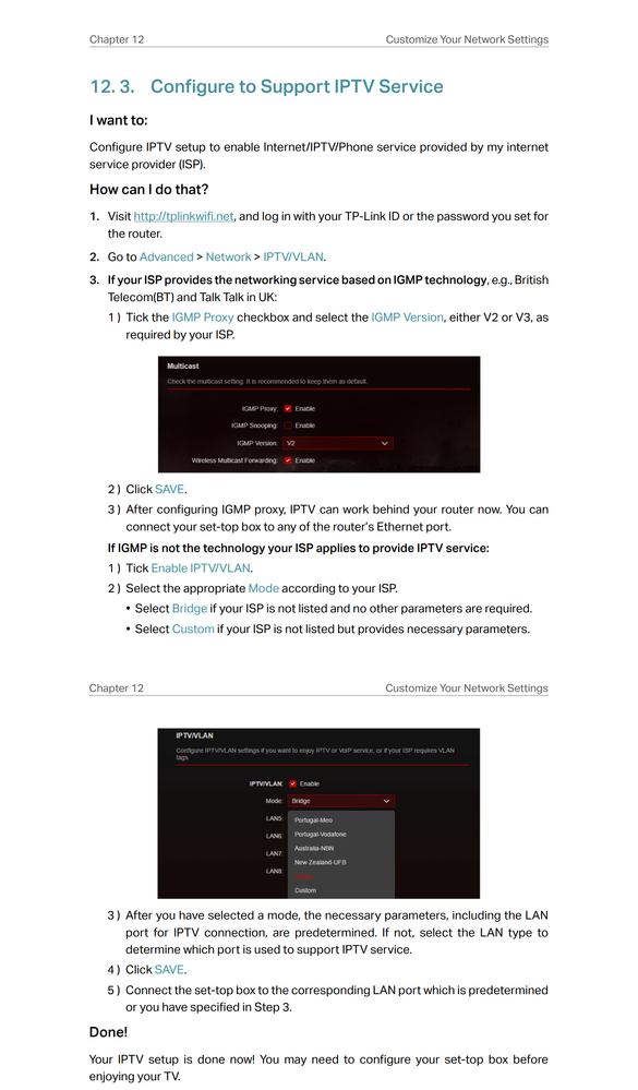

Has anyone Ever Set Up A Personal Capable Router For Telus IP TV?
Has anyone ever done this successfully with any other router than the Telus routers?
Ex: TP-Link AX11000 Manual, P 71- 72
https://static.tp-link.com/upload/manual/2022/202202/20220228/1910012815_Archer%20AX11000(EU)_UG_REV1.1.2.pdf
