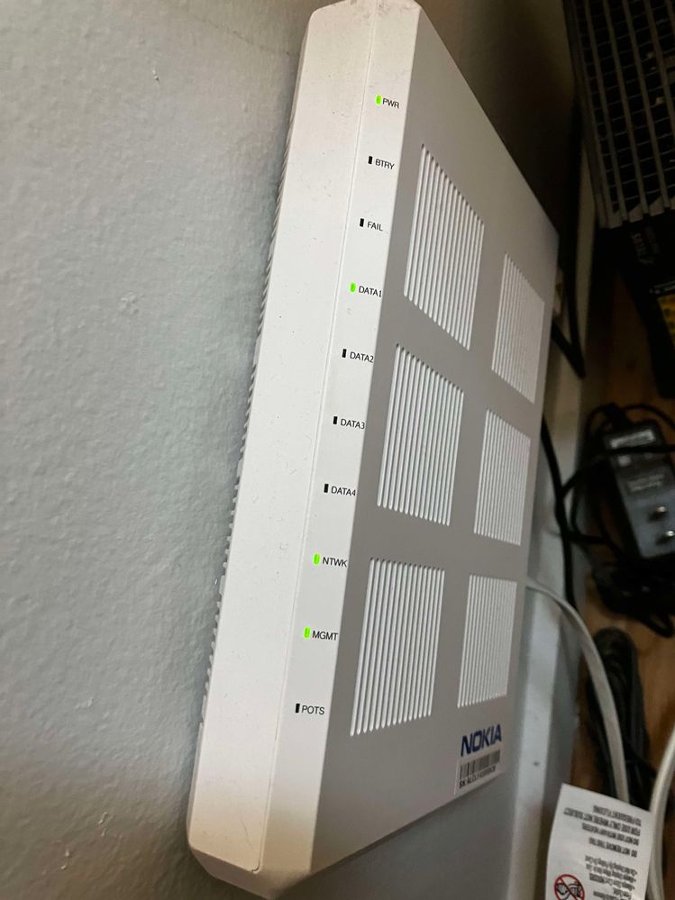

    UPDATE: the data port mystery is solved. The LEDs on the top of the ONT are in reverse order from the ports on the bottom, which is mind-bogglingly bad design (see attached photo). You can disregard my first question entirely.

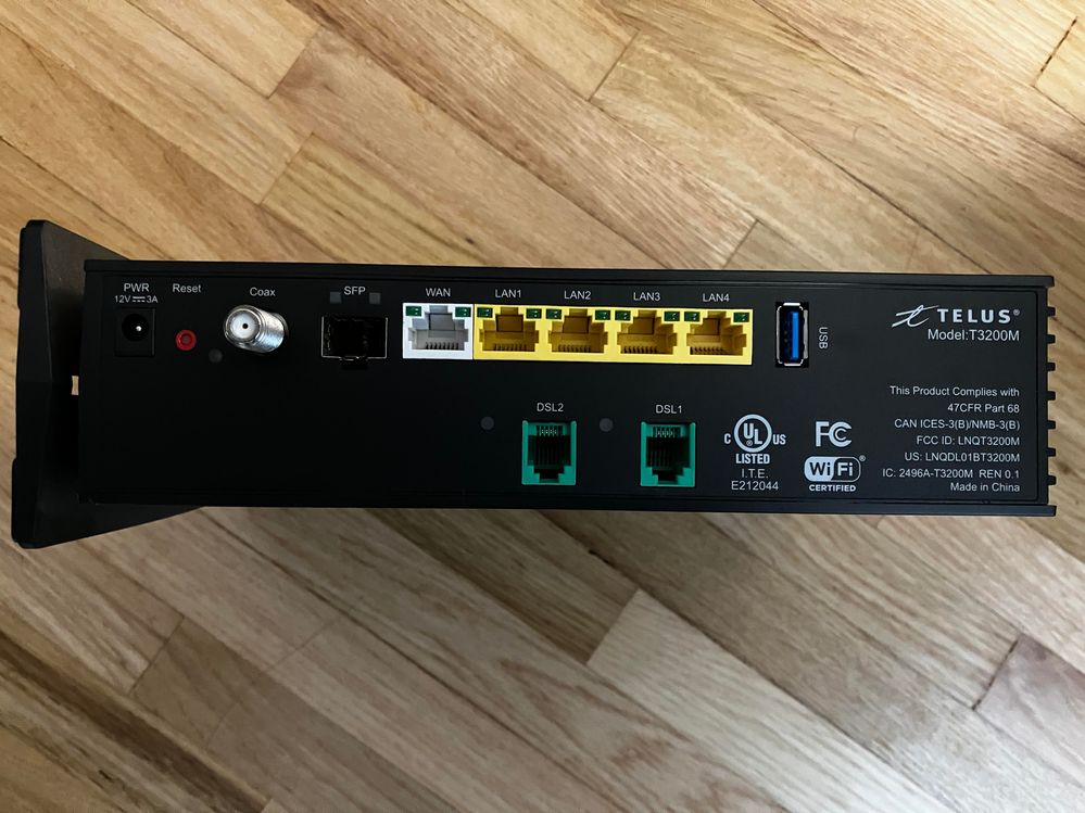

    After doing a bit more research, it looks like my plan should deliver 940 Mbps, which converts to roughly 9.4 MB/s, so I guess I'm getting close to max speeds from the PC plugged into the M5's ethernet port. I have a Telus modem as well, but I'm not currently using it (see attached photo). Do you think there is any benefit to plugging this into one of the DATA ports and giving the PC it's own connection?

    Thanks for the explanation about the ONT. I do not really understand networking, so I don't understand the difference between a switch and a router, or which one the Deco M5 is functioning as, but at least now I understand the function of the ONT! I did have something wrong in my original post--I thought the M5 was plugged into the NTWK port, but it is actually plugged into the DATA4 port, which strangely does not show a green LED, the LED is not lit up at all. (see attached photo).
    One question I had, if you are willing to take the time to explain, is why my Deco M5 is plugged into the DATA4 port on my ONT, which seems to work fine despite not showing a green LED. If I plug it into the DATA1 port, which has a green LED, it does not seem to work. My PC reports no connectivity when plugged into the Deco M5 (and my wifi network does the same). I ran the network adapter troubleshooter (Windows 10) and it reported these two errors:

    Keep in mind the ONT is not a router. All it does is convert fibre to copper. Only one port on the ONT is going to be active. There is no way to activate the rest of the ports.
    Connecting a PC to the ONT is not a recommended practice as it would expose it directly to the internet. It would also be outside of your home network. The only way to connect two devices to the ONT is with a gigabit switch connected to DATA1 on the ONT. If you need more ports on your home network, attach a gigabit switch to the ethernet port on the Deco M5.
