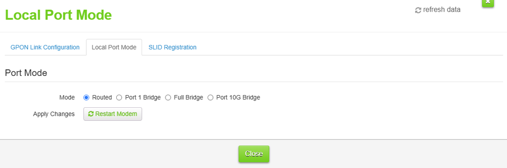

  • You want to use a personal router brands like asus, tplink, netgear and other brands and manufacturer routers to bridge between your peronal router and your telus modem.
    You want to use port 1 bridge or port 10G bridge.

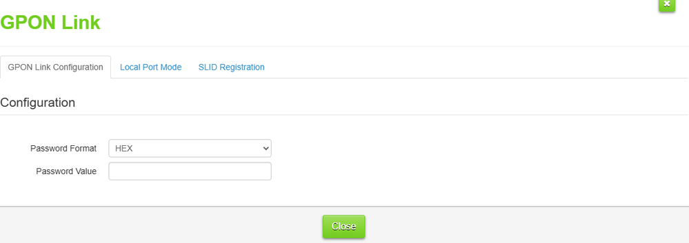

    I have attatched a few pictures of the settings of the bridge mode for Telus netowk access hub :
    I will attatch a few pictures for this setting from

      The pictures you attached, they do not look familiar to me in my NH20A GUI, are these from a different TELUS device?

        They NH20 A GUI should be similar for residential telus customers for the settings.
        A possibility , the NH20A ,each  telus modem has different firmware updates or software versions.
  • I got it to work a couple days ago (Thursday). Was in a weird spot under a drop down menu in LAN. I also have a 10Gbps 5 port switch in between by pfSense box and the NAH. It's not directly connected. I chose the 10G option
