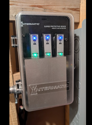

        We had a lightning hit a tree about 30 feet from our house a few years ago, took out my sprinkler and septic controllers as well as our DSL router (back than) and a bunch of other things so I put this unit in connected to the panel I'm guessing this might be why the powerline WIFI didn't work.
