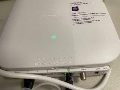

    The first thing that would be helpful is knowing what hardware you are currently utilizing within your network, i.e., which specific switch model, and which specific NIC adapters?
    As well the current Telus modem that has been installed would be helpful as well. For example, is it the one that is displayed below?
    If so, are you utilizing it as your router/firewall, or has it been placed in bridged mode. If the latter, has it been fully bridged on all ports, or just the 10Gbps port?
    Again, lets see if we can get this figured out for you, Cheers...

    If it's the gateway I think you have, I believe there is only one multi-gig port and the rest are gigabit. You'd need a 2.5gbps or faster switch if you want to connect multiple devices over a gigabit. Unfortunately those switches are very pricey.
